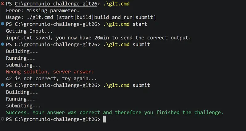

grommunio employees had created new user accounts on the computers, set up VSCode as the editor, and automated various commands via Windows cmd scripts to speed up the compilation and submission process.
Coding Challenge - code
A participant successfully completing the challenge with the tools provided by grommunio.
“We set up a small HTTP endpoint that, in combination with a shell script on the challenge computers, allowed us to generate personalized input for each participant based on their email address and then respond with feedback on their attempts to solve the problem,” explains Fabian Ortner of grommunio (pictured above). “A Readme file then provided a more detailed description of what needed to be done for the programming task, and so a fairly simple, automated process was created to make participation as easy as possible.”

1. To Register your E-Mail address and start the 20min timer:
.\glt.cmd start
2. To just build your code:
.\glt.cmd build
3. To build and run your code and print it’s output to the terminal:
.\glt.cmd build_and_run
4. To build, run and submit your solution:
.\glt.cmd submit
